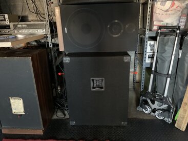

Few days ago I turned on my equipment as normal and no sound from my passive EAW SB1000Sub. So to test, I pulled out the speakers and removed the cable and plugged into my EV Eliminator i Series 15" full range speakers:
https://av.loyola.com/products/audio/ev-eliminator-i.html
and I cannot believe the bass I am getting from it, I mean serious "punch"! Also, I was totally surprised that I was getting the bass more evenly now anywhere in the room. So as a test I placed the EV's in the middle along the back wall but facing the side walls as that was the position they were in when I had tested them in the middle of the room. I got the same result!
As was known before, the placement of the sub in this crappy room is everything. I had first placed the two 15's at the back wall facing forward like the EAW and they sounded crappy but when I turned them to the side facing the side wall BIG difference.
So now I want to do the same with the EAW by placing it at the back wall but facing the side walls instead of facing forward. What I would like to know is if this would be safe for the woofers in the EAW. Reason being, with the smaller EV's there is about 10" free space on both front and back between the 2 storage shelves on both sides of it so not much or any issue I think. This is a pic of the situation attached. Those are the EV's with the side view with the red arrows showing the space on both sides between the shelving on the left and right of the speakers.
With the EAW however, if I should place in in that spot it will be a tight fit so not much free space at all between the front of it and the shelves. I am thinking the contents of the shelves will block the waves from the woofers? Any thoughts/advice on this please?
