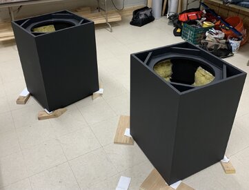

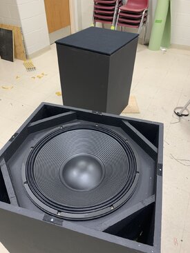

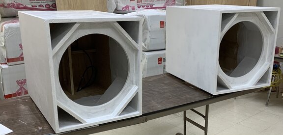

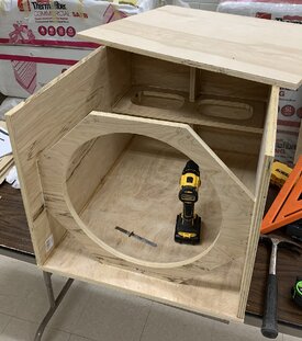

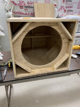

I built a set of subs using Beyma's 18QLEX1600FE 1600 Watt RMS speakers.
Wow. The sound the enclosure and speaker produces exceeded my expectations.
Kick drum solid thuds that really pound, the low E note on a bass guitar, or the low synthesizer sounds really makes the sound come alive in the large sanctuary.
Each sub gets is signal from an Ashley Protea 4x8 processor which does the timing and electronic signal divisions using a standard 48dB/octave Linkwitz-Riley crossover.
The signal to each sub has its own bridged QSC CX-1102 amp providing 3400 Watt RMS at each sub.

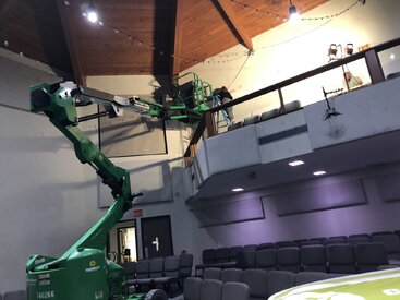

Sanctuary room treatment consists of 3000 Sq Ft of 4" thick Owens/Corning SAFB (see the pic with the man lift).
