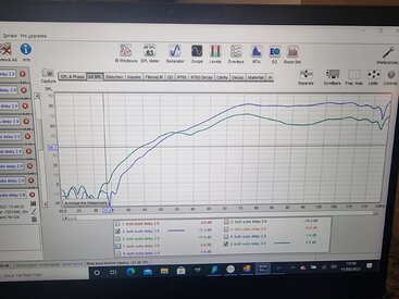

I hooked the headphone out of the PC to the AVR, its the curve in green (which is very similar to the PC direct to sub) and compared with the hdmi PC out to the avril in violet

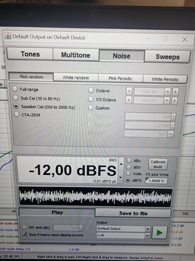

These are the settings for the noise generation in REW

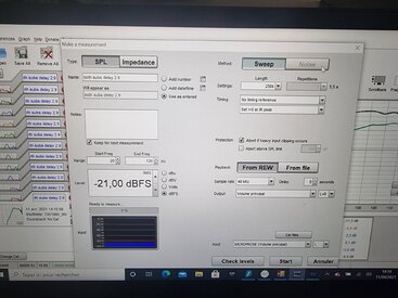

If you want to use pink noise for RTA measurement it has to be full range! The speaker cal signal rolls off below 500 Hz and above 2 kHz, it is used for speaker level checks, not measurement. It is better to use Pink Periodic Noise (again, full range) or to make sweep measurements.

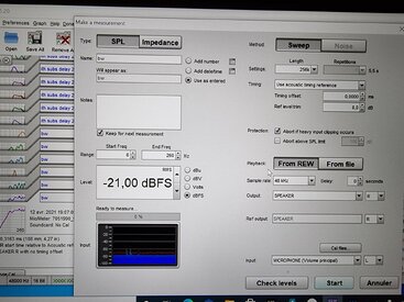

This is what I have for the measurement. It seems I cannot change to noise.

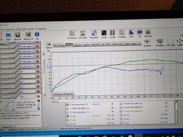

I'm totally puzzled, I've now tried with a new sub connected directly to the out of the PC. It's a B&W PV1D. And I still get a similar measure...
The green curve is the B&W sub

Could it be that the level in the measurement is wrong ?

7,315
Please post an mdat file, but you aren't comparing like with like. Align the measurements so they have the same level at around 105 Hz (use the offset tool in the graph controls) and you will see the difference in extension more easily.

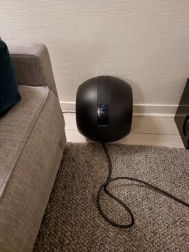

Please post an mdat file. Where are you placing the subs in the room when you measure them?
Matt1980
Oct 24, 2020
44

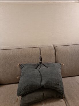

The sub is on a side wall
7,315
The measurement looks odd, more like a measurement of the main speakers than the sub. How do you have the sub connected? How does the measurement look if the sub is turned off? Can you post one of your Focal measurements?
