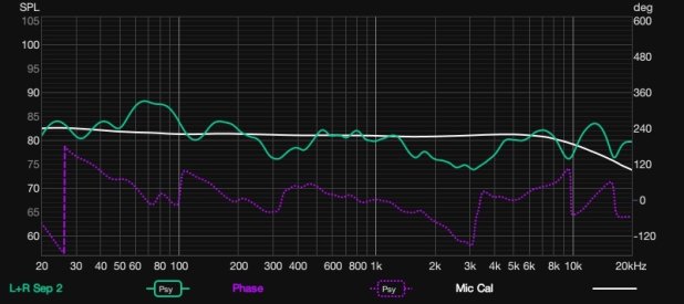

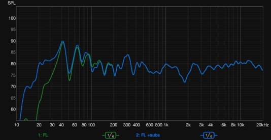

I have made my first measurements and I have difficulty to judge them. I am measuring in a living room 2 Klipsch RP 8000F and Klipsch SPL 120. Crossover is set at 80 Hz.
I first used psychoacoustic filters which made it look flat. But with var filters it looks more wild.
How do you interpret my measurements?
Is this considered normal?
I will add a second SPL 120 soon. Music and movies sound great, but I wanted to measure the levels to tune in the subwoofer and now I am even more unsure, if this is all good. :)

The info you need can be found in the REW manual - here. In a nutshell: psychacoustic smoothing (and ERB smoothing) reflect what you hear. Variable smoothing has more "resolution" in the lower frequencies and less in the upper frequencies, which is what you want if you are going to prepare your measurement for DSP.
Thanks and yes, I understand. But out of experience dies this look good or bad?
I will add anstehe subwoofer and find the appropriate Position using REW, but my possibilities using DSP are limited. The subwoofers for example are not possible to set timings for separately.
The first thing you should do is compare your measurement to published measurements. Luckily for you, Erin reviewed your speaker here. If you placed your mic at the listening position, then what you expect to measure is the PIR (Predicted In-Room Response). Scroll down a bit and it's here:
If you look closely, it's not quite the same. Your measurement has a broad dip between 1.5khz - 4kHz of up to 7-8dB. Erin's measurement has a dip between 1kHz - 2kHz. Note that the PIR has an error of +/- 1.5dB depending on your room (darker green band). Ask yourself why your measurement has that dip. It is usually because of improper measurement technique, e.g. if you used a mini tripod and perched it on top of furniture - i.e. it may be a measurement artefact.
Those bass anomalies in your measurement are expected and will be seen in every listening room.
For general viewing, most of us use 1/6 or 1/12 octave smoothing.

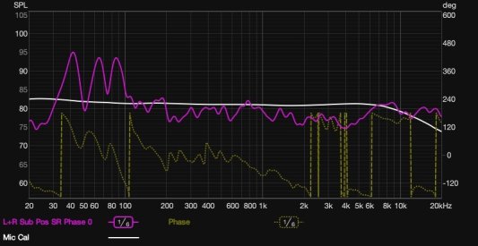

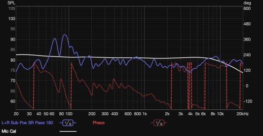

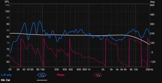

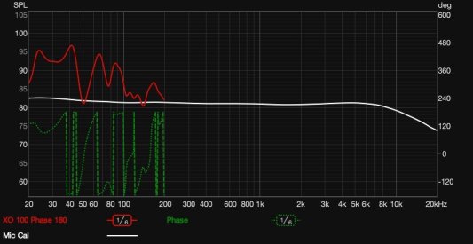

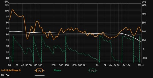

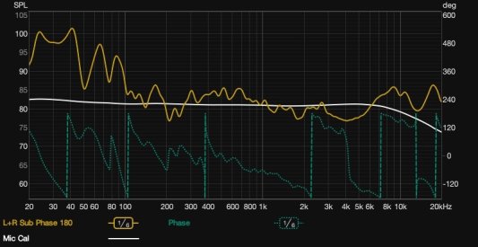

Ok, I have better measurements:
See titles at the bottom left

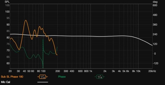

I then moved the Sub to the back (Surround left and right (SL, SR)

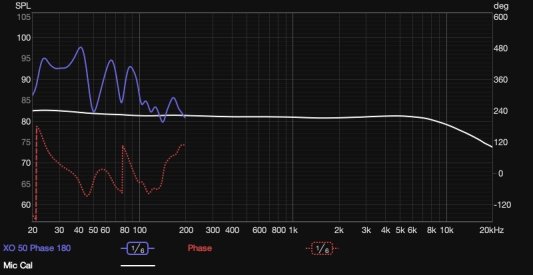

And interestingly the XO doesn't really have an effect (measured at the front)
This is all with the Klipsch SPL-120. It will be accompanied with a Klipsch PR-1000SW.
Especially at the back I almost don't get any volume from the sub. (no correction for that position applied).
I levelled all speaker to 75 dB(A) and the sub to 75 dB(C) using pink periodic noise.
What do you think?
1. Please download and read my REW measurements interpretation guide so that you can understand how to read the measurements yourself.
2. When comparing measurements, they should be overlaid. It is very difficult to look at one measurement, try to remember it, then look at another measurement to spot the differences.
3. You can easily see from your own measurement (when compared against that white line which I presume is some kind of target curve) that you have too much bass. Your bass isn't as smooth as it should be ... but then only so much can be done if you don't have DSP.
4. Why are you using dBA for the speakers and dBC for the sub? Just use pink noise (not periodic) and use dBC.
5. It is always best to upload an MDAT.
