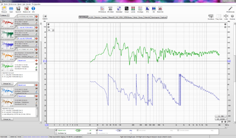

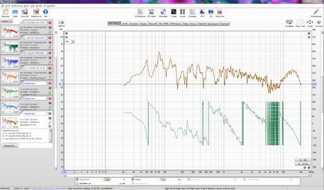

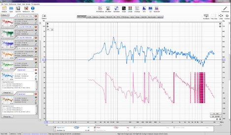

In the first screenshot, the sum of the left and right channels, if aligned well. On the other two, the same amount, but incorrectly aligned. Similar to your measurements.
This suggests that your tweeters are working together and separately as they should. And what we see in your measurements is a matter of measurements.
