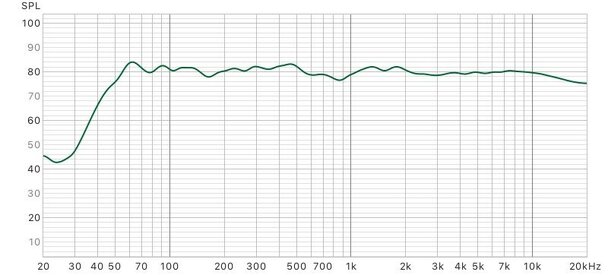

Its pretty flat as it is. Im happy with it. I attached a photo of it.

I mean, ya you need to treat it, but itll never be super flat unless you EQ it.

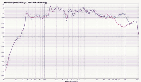

A single graph of Frequency Response is a bit suspect. Unless the mic is perfectly central in a perfectly acoustically symmetrical room, there will be HF comb filtering. Flat is tilted about 6dB brighter than the average measured listeners room.
I 100% agree, it is a good to take several measurments and then average them, here is an image of possible microphone placements. Note that it's a cube centered the head.
I love Dirac, use it every day in the Studio. But for Measuring REW. Here is what happens when the Measuring Mic is not precisely central. Comb filtering destroys the HF.
