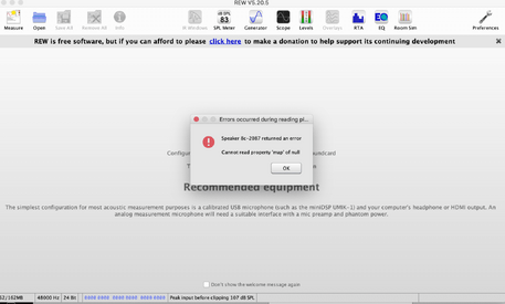

Hi John, in my continued effort to get this working, I tried another experiment. This time, I ran an ethernet cable from my router to the switcher, in which both 8C's are connected to. This time, I get an error message (screenshot attached).

7,314
I have seen that logged occasionally, usually soon after turning the speakers on. If you use the "Scan network for speakers" option on the Filter tasks pane of the EQ window you can see if that persists.

12
Hi John, just to update you, the null error message is persisting, even after "scan Network for Speakers'. I was able to measure one of my 8C's by connecting it directly to the router, but I've hit another roadblock with this null error message.
7,314
I had one report from an 8c user with a similar problem that only affected one speaker of his pair, that was cured by rolling back and reinstalling the last 8c firmware update he had installed.
