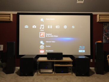

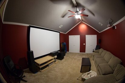

So a few details:
Room size: 14.3'W x 20.75'L with sides of room at 8' and peak at 12'. I've measured exactly 3,000cu-ft of space.
I've since placed my homemade rack in the dead center of screen and my center channel sits on it. I have a single HSU VTF-15 mk2 sub and it sits between the center channel and right speaker. There is space for one more sub at the same location but left speaker. Symmetrical.

Dual HSU subs are in!!!
What a dramatic difference having two subs are.... wow. So much more impact and they never felt stressed and boy do they really shake the room now. I should of never waited this long. I couldn't imagine more bass than this... these things are scary.
