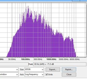

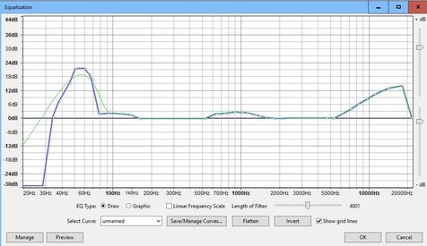

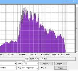

I find this an interesting approach, years ago I almost purchased a 1/3 octave graphic equaliser because of the differences in recordings. In fact a lot of "Golden Ears", back then, could tell what studio an album had been mixed in due to the differences in their reference speakers.
I find some of Bruce Springsteen's early albums lacking in the low end as well as Leonard Cohen's so I have been having a play around with this and on the pc it definitely sounds better. (EQ only at the moment)
Here is LC's classic "Famous Blue Raincoat"
Just lifting the bass has given it a richer sound and I also played with the hole in the 500 - 1500 Hz area.
The top end though from 9kHz and up is almost non-existent.
