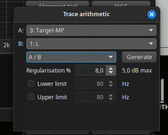

It's unclear to me how you are getting any boosting over zero on the scale in REW with your filters. Following my guide, you should not see anything reach up over 0.. If Max Gain is left at 0.0 you should have no positive amplitude adjustments. There must be a discrepancy based on your version of REW.
When I have some more time I’ll upgrade and start over.
The trace arithmetic control panel on the version I’m using has a “regularisation” (Sp?) control and not “max gain”. Not sure what “regularisation “ does.
I also used measurements created in Impala and imported to REW. Perhaps there is some unwanted small change taking place on the impulse response import. I’ll take them in REW next time.
That is correct. IIRC Example of regulation that I tested a few times: 8% = 5dB max

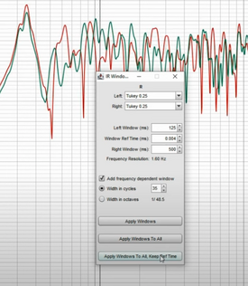

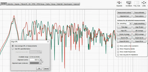

I tried to prepare the traces, I have 6, not 2, before applying @moedra 's method. Is it overkill? It sounds differently, very subtle. I can't decide which is best.
I first windowed the traces, then time aligned, and lastly SPL aligned at 500Hz. Then I followed the recommended procedure and generaed new filters. With CamillaDSP, I can switch at the press of a button. 1.png 2.png 3.png 4.png
I first windowed the traces, then time aligned, and lastly SPL aligned at 500Hz. Then I followed the recommended procedure and generaed new filters. With CamillaDSP, I can switch at the press of a button.View attachment 74224View attachment 74225View attachment 74226View attachment 74227
The problem with FDW in Room EQ Wizard is that it is applied without a psychoacoustic treatment ahead of it. This may be appropriate in certain situations but if the goal is to generate perceptually accurate acoustic correction, you have to apply a psychoacoustic treatment to the response ahead of the FDW. I studied how Acourate does this, but REW doesn't have an equivalent feature that I'm aware of. If you don't treat the response first, the FDW will include the deep dips that I can see in your graphs, which is not what we want. I got around that by simply smoothing the data to 1/12 and leaving FDW out of the recipe, which yields a result much closer to that treated FDW response that I see in Acourate's macro 1. Of course, in REW you have to bake that smoothing into the measurement, which is why I export the smoothed measurements as txt files, bring them back into the session, and process them instead of the original measured responses. REW seems to ignore smoothing settings (they are likely just visual filters) when it performs the necessary calculations, so you can't just smooth the original measurements for processing. I tried that for a long time before figuring all of this out. You need the smoothed txt imports for the math. The procedure I wrote in that guide essentially emulates what Acourate does in macros 1, 2, and 3, but without the need for FDW.
I don't think you needed to align SPL either, as this will surely cause the L/R balance to be thrown off slightly in the filter. Why do you have six measurements? Yes, I think it's overkill.
The problem with FDW in Room EQ Wizard is that it is applied without a psychoacoustic treatment ahead of it. This may be appropriate in certain situations but if the goal is to generate perceptually accurate acoustic correction, you have to apply a psychoacoustic treatment to the response ahead of the FDW. I studied how Acourate does this, but REW doesn't have an equivalent feature that I'm aware of. If you don't treat the response first, the FDW will ignore the deep dips that I can see in your graphs. I got around that by simply smoothing the data to 1/12 and leaving FDW out of the recipe, which yields a result much closer to that treated FDW response that I see in Acourate's macro 1. Of course, in REW you have to bake that smoothing into the measurement, which is why I export the smoothed measurements as txt files, bring them back into the session, and process them instead of the original measured responses. REW seems to ignore smoothing settings (they are likely just visual filters) when it performs the necessary calculations, so you can't just smooth the original measurements for processing. I tried that for a long time before figuring all of this out. You need the smoothed txt imports for the math. The procedure I wrote in that guide essentially emulates what Acourate does in macros 1, 2, and 3, but without the need for FDW.
Thanks for the detailed explanation. Totally makes sense.
It's my home theatre. 6 channels. For my stereo I didn't bother.
My response featured a typo, which I have fixed. It said that FDW will ignore the dips. What I meant to say was that the FDW will not ignore the dips. We don't want those dips included in the FDW calculations. Acourate's psychoacoustic treatment removes them prior to applying FDW. The only way to mimic that result (while retaining accuracy) with REW is to use the exported/imported responses with the smoothing baked into them. Therefore, applying FDW with REW for our purpose is unnecessary.

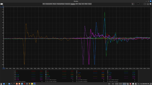

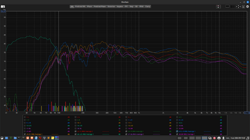

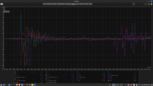

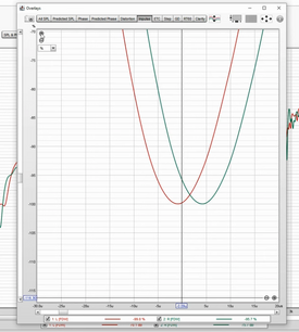

Using your method, and remeasuring wth the filters on gives a dispersed impulse response.
What I'm trying to do is to get all the speakers to fire delayed by using the delays from that measurements and set them as offsets in the DSP. Here I took a set of measurements and due to minor difference in the mic position, the impulses that should normally be all at t=0 are within plus or minus 150 uSec. Is it something desirable to want to see all the speakers to fire simultaneouly from the MLP perspective?
Here's the corrected response I get BTW,
You're still boosting during the inversion, which is giving you approximately 7 or 8 decibels of boost above 0dB around 2600Hz. The region between 2000Hz and 4500Hz is boosted. There's a little boosting above 0dB at 1kHz as well. When you do the inversion, leave the boost amount (max gain) at 0.0 like I have in the picture. This is somewhat vital to avoid potential problems clipping the output of the convolver running the filter. Look at mine again. There's nothing going over zero.

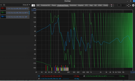

A question. I've been wondering for quite a time what exporting IR to wav with minimum phase ticked was doing precisely. I do understand they are audio files and as such do not content phase information like text files would.
Being curious, I imported one of my IR wav filters in REW as audio data and clearly they're not minimal phase.
2 (green) is the right channel imported wav phase; 3 (blue) is a minimum phase copy I created of it in REW
It export the IR of the minimum phase response generated from the system's magnitude response.
When you import an IR you need to make sure t=0 is set appropriately to see the correct phase response, otherwise the phase will include a time delay.
