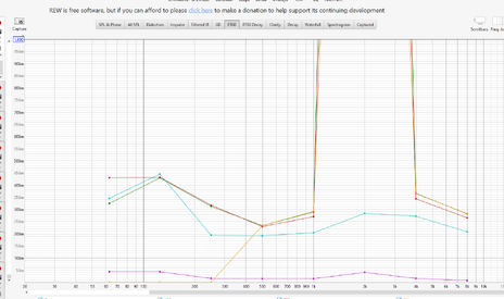

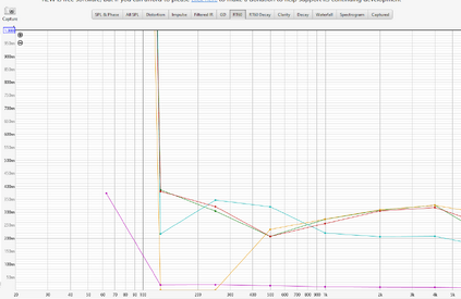

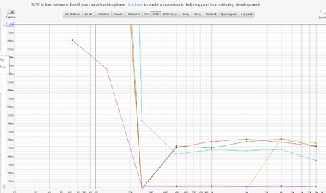

Hi All,
I recently got a new 8 Channel Amp for my heights and surrounds. Outside of having a bad 3rd channel, I'm getting some periodic weird results in the RT60 graph which I don't understand.
I've also never taken measurements using the "Atmos Channel" from file method. So perhaps that's causing an issue? I've never seen this happen before though.
  • New vs Old Amps.mdat

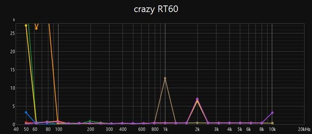

Here's another pic and MDAT. I just repeatedly measured the same speaker.
  • repeated attempts of left surround.mdat

There's something very wrong; the noise floor in all of your first set of measurements is 30 dB, all the way up to 20 kHz.
sam_adams
May 23, 2017
287
The measurement level is fairly low, ≈ 60dB SPL. The room noise floor is between 30 dB and 40 dB SPL. Try increasing the sweep level 15 dB to 20 dB and the sweep length to 256K to improve the S/N ratio.

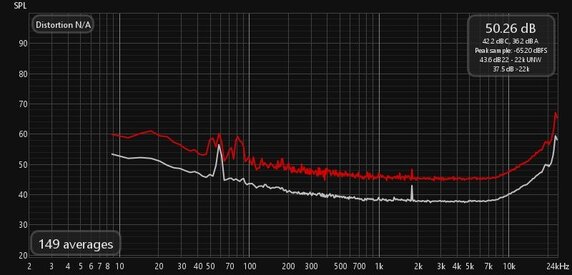

If you run the RTA (Spectrum, No smoothing, 64k, Forever, Hann, 50%) for a minute or so in the room with the AVR turned off, to measure background noise, what does the result look like?
tjcinnamon
Dec 6, 2020
123
There was one bump from upstairs at 70Hz

Hmm, perhaps the noise floor in your mdat files is reasonable for a UMIK-1, versus the UMIK-2 I'm now using. My old UMIK-1 measurements have a higher noise floor than my UMIK-2, although still not as high as yours. But your RTA measurement still doesn't make sense to me.
thothsong
Jun 29, 2021
393
As @sam_adams indicated, there's usually less than 30 dB separation between your measured SPL levels and your noise floor, and sometimes barely 20 dB, which presumably causes the RT60 calculations to go large, as there isn't sufficient decay over time before hitting the noise floor. If your RTA measurement was somehow just a fluke, then as suggested the fix is to run the sweeps at a sufficiently high SPL.
