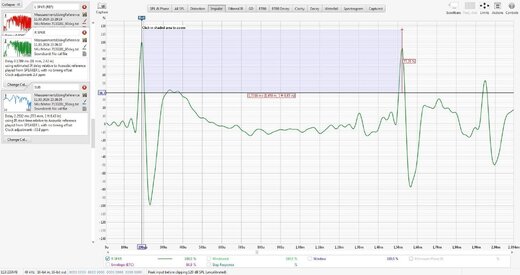

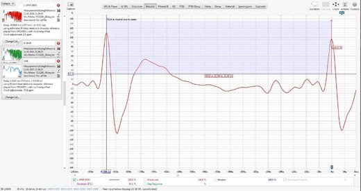

@sm52 - Here are measurements (individual L/R/Sub) using the tweeter on the left speaker as a timing reference but the subwoofer sweep was just to 300Hz, so will re-run later. Not sure what to do to correct the IR issue. I do get a chirp sound at the beginning and end of the sweep which is contrary to the description in the MiniDSP document.

Now the measurements are correct. The screenshots show impulses from the left and right speakers. When measuring the left one, after 0.88 ms a second impulse appears, which should not exist. When measuring the right one, after 1.33 ms a second impulse appears, which should not exist. With such a small difference between the impulses, you may not notice the sound of the two speakers by ear. But it seems like there are always two speakers. Somewhere in the REW or miniDSP settings, some setting sends a measurement sweep to not one speaker, but two.
As for the relationship between the main speakers and the sub, it is previously necessary to make a subwoofer 2.9 m closer than now, or 8.7 ms earlier than now.

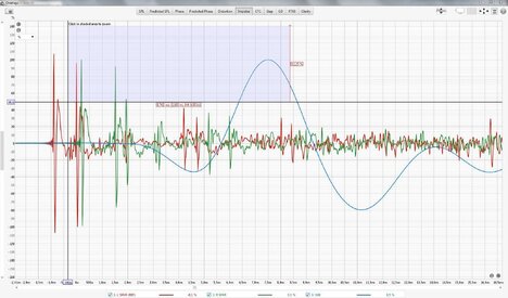

'Overlays' button, 'Impuls' tab. I have highlighted the time distance approximately. Because due to the double impulse, it is not clear which time point should be considered the beginning.

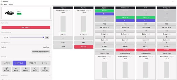

You might check the XOs or routing in the MiniDSP for the source of the 2nd impulse if not done already. You can post screenshots if you like.

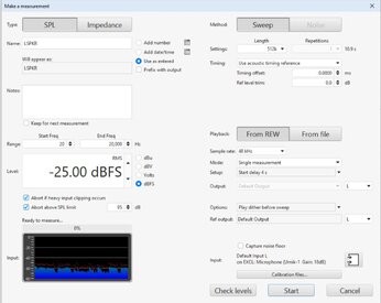

Here are the settings on MiniDSP and the .mdat for the recorded sweep of just the left speaker.

Try disabling the 'Play dither before sweep' option in the measurement window.
After starting the measurement for the left speaker (output L, ref output L), move close to the right speaker to hear if it play the sweep while measuring the left speaker.

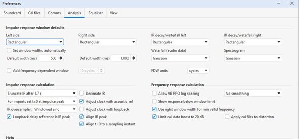

No joy, 2nd impulse is still visible and the right speaker is dead silent during the sweep. @sm52 I attached the REW preferences settings hoping for a hint.
