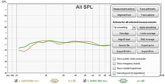

The twitter naturally was more flat but I haven't measured of axis yet.
40508
Figure 5:Twitter before and after EQ.
The twitter had only 2 EQ filters: 1999 Hz Gain -2.3, 1739 Hz Gain -1.7 dB.

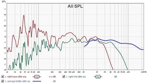

40509
Figure 6: All drivers after EQ.
Now figure 6 is far from perfect but it helped me choose my Xover filters. I crossed the base/mid at 640hz linkwitz riley 12db/octave and the mid/twiter at 2Khz linkwitz riley 12db/octave for mid and 24db/octave for twitter.
