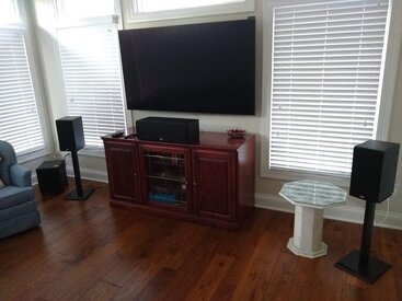

My room is certainly a challange. The dimensions at 14 x 14 x 9 is an issue but the surfaces compound the problem. 2 walls (front and left side) are almost completely windows covered by hard-surfaced horizontal blind slats (maybe some diffusion ...). The back wall and 1/2 right side walls are drywall covered with sound insulation behind them, 1/2 right wall is open to a much bigger volume, floor is wood glued over concrete and ceiling is heavily insulated drywall. Sofa is up against back wall with MLP about 10 ft from cc which sits atop a cabinet (at the leading edge).

I'm working on the room. First step is a big carpet rug (8 x 8) to cover the floor in between the cabinet and the MLP, a couple of weeks away. I've played with the speaker position and even moving chairs around (like the blue one in the pic) to break up the path between the L/R speakers and the adjacent walls. I have tried the "slap test" and I don't hear an obvious echo but with old ears and undiscriminating listening skills I may be missing something.
