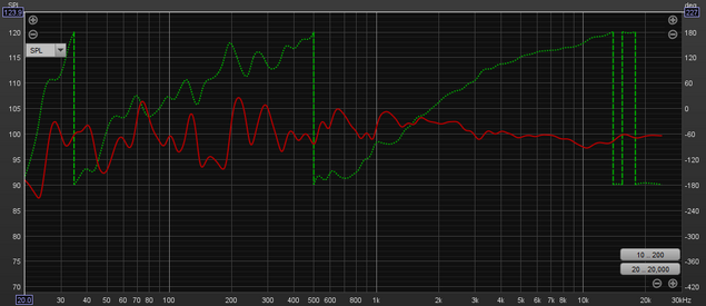

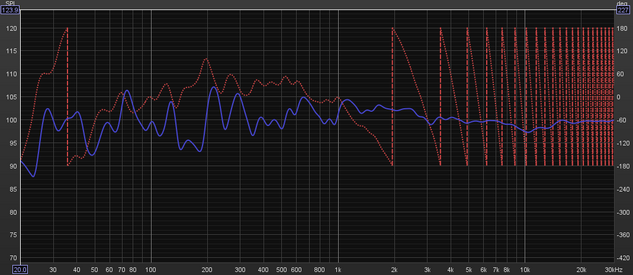

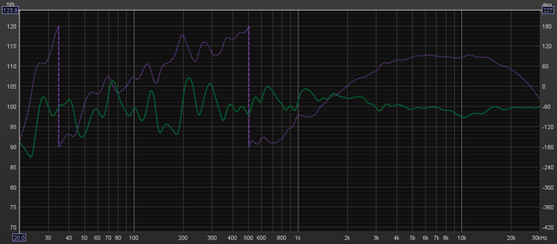

Second issue I also have noticed and am not sure if this is intentional or not, but the phase response of each correction filter is different depending on the sample rate you check. Not sure if this is something to do with pre-ringing prevention or whether it's unintentional? (See attached images of the same correction at different rates showing very different phase responses). All these were generated at the same time by just checking the different sample rate boxes when outputting from Audiolense.
