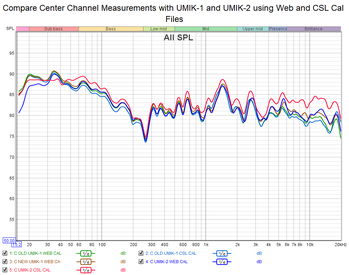

Once again, a comparison of the UMIK-1 and UMIK-2 mics based on personal experience.
First, a comparison of custom CSL cal files for both mics:
54828
Second, a comparison of actual REW measurements. I have two UMIK-1 mics, the "old" UMIK-1 has both CSL and web cal files, while the "new" UMIK-1 has only the web cal file. The UMIK-2 has both the CSL and the web cal files. The measurements are actually quite similar, with the CSL UMIK-2 being a bit flatter in the low end and a bit higher in the top end. Regardless, with my Dirac Live calibrations, I can't hear any obvious differences using either mic with any of the cal files.

it’s pretty easy to make some REW sweeps and call them the same. So stop posting comparisons of REW sweeps when talking about Dirac.
I wish I know exactly what Dirac was doing…… then we could post screenshots that actually mean something.
The only thing placebo I can see is these REW screenshots that are not the DLCT
