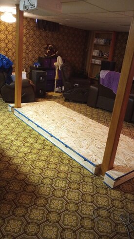

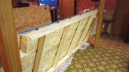

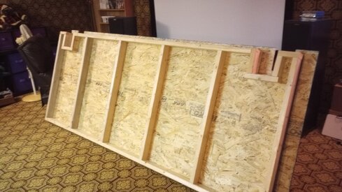

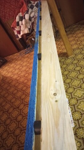

I am also looking for input on this subject. I just built a riser that I am going to put 9 Dayton (BST -1) in and also stuff it with insulation to create a bass trap at the same time. Specifically time delay is my concern. Eventually I will have 4 subs running off of the mini dsp. If I use a Y splitter off of 1 of the channels will this be sufficient? I currently only have 3 so it isn't a problem yet. I should receive the shakers in about a week.
I was also wanting input from others that have built risers for options they wish they had included. I think that I will do some lighting and was wondering about putting a power outlet (110) in it.
Any input is welcomed.
