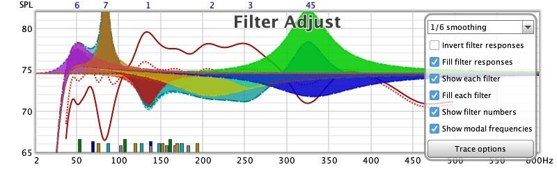

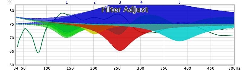

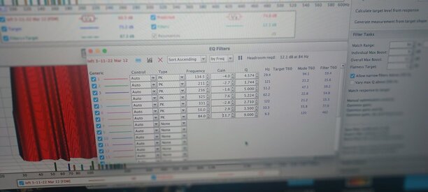

Attached are the specific EQ filters that have been assigned by REW, but some I kind of manipulated myself. Overall I am satisfied with the response I would get once the filters are enabled, however I am really having and issue trying to make sure that I have these filters saved and loaded into the Waves IR-1 convultion reverb plug in. I can load it but I don't think its loaded right. perhaps I didn't save the filters correctly. I don't know. I could really use some tech help on this one.
Also how can I make sure that the filters are actually transferred to the plug in and working? I have PAZ analyzer and thought having it on the master bus and the IR-1 on an Aux, I could simply bypass the plug in and see the results on the PAZ but I am really not seeing any difference.

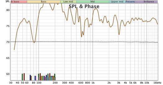

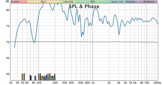

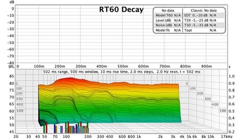

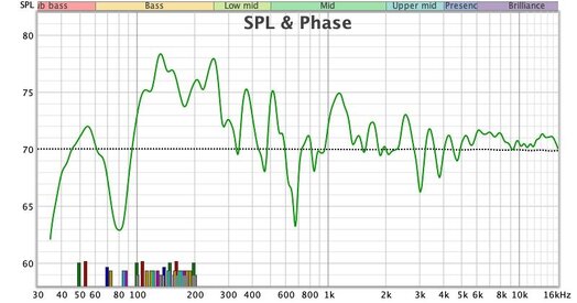

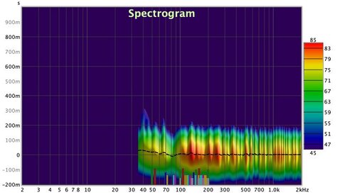

Hey check this out! This whole time I have been only interested in 40Hz to 500Hz in doing my treatment. I decided to run up to 16,000kHz today, with independent Left and Right and also Stereo L&R and this is the IR that was graphed. I ran for 2M length to get the best and longest sweep that seemed practical andI notated that the sweep was -12 reading an SPL of 78 for the stereo L&R together which yielded a 75 SPL target that I have been aiming for. When I measured the Right and Left speakers individually the sweep stayed at -12 with a 72 SPL. I am kinda amazed at this graph and feel like maybe I did something wrong, cause it is pretty ideal for my room. The only correction I want to make is the slight peak in the 250 to 400 Hz range, which I believe I may be able to correct with my IR-1 plug in, but I'll still need to work that out. I am really suspicious that I am getting this kind of IR. I hope its true.
