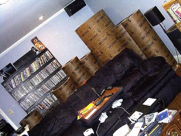

Back in the 1990s(rockin the dreamcast and audio control 3051!), having fun with various DIY tries in my living room.

That's quite a collection of CDs... not to mention cylinder subs (?)!
