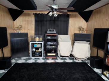

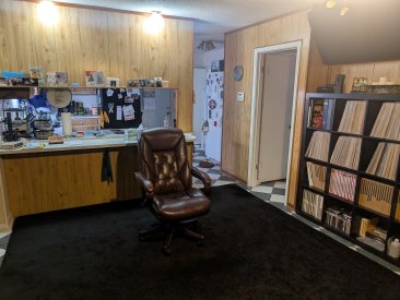

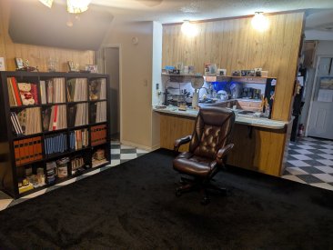

So recently I asked a friend to help me with getting my room back to where it once was, so I measured the room and we made some changes now it sounds better.
I want to add more treatment to improve the low end and some reflections. I am gonna post this thread and then add pics any advice is helpful...
The pics have been added, now what to do first? The rear wall, behind the curtains is two windows, or the wall/ceiling in the front of the room?

Wow!!! Over 260 views and no replies, did I post this in the wrong forum?
No, you posted in the correct spot. It's a tough room though, being open to your kitchen in the back. The front of the room is treated quite nicely. I noticed some treatments in the top front corners, any thought to putting full bass traps in the corners to help the low end?
Well I can't fit anything on top of the speakers and really don't want to put anything on them. I can do a wall/ceiling on both sides of the room like I did in the rear, 2' x 4' x 6" panel.
Also I can fit two of the same panels behind the curtains, just want to do whats gonna be most effective first...
I am also gonna install treatment on the rear wall, again I want to do what will get me the most results first...
Ah, Corner Horns... Don't over treat the front walls... Maybe time to think about Room Correction DSP instead of more physical treatment...

Ok when I am listening to the music the bass sounds good from the LP but, if I stand up or move away from the LP the bass becomes louder and a little boomier. So I am thinking I need a little more treatment for the low end. Everything else sounds great I have a large soundstage and very clear Phantom channel coming directly from the middle of everything.
It does not look like you have a lot of choices for the back wall... Maybe on the wall, ceiling and floor behind the MLP using a range limiter tech... Would you mind telling us what your room dimensions are?
Sure 16 x 13.5 x 8.0 in feet.
Given your room layout and dimensions, I think you need to focus on the 35Hz, 42 Hz, and 70Hz room modes... That 70Hz is most likely a ceiling issue... So maybe a little more focused ceiling absorption a little forward of to over the MLP... I'll keep looking into this...
Ok thanks for looking into this and your help. I am about to order some treatment but I will wait till after you have looked a little more...
Just throwing in my $.02,
1. For treatments, I would try the side walls with a little damping, not too heavy: it might help longitudinal low end reflections
2. A heavy curtain over the kitchen opening, floor to ceiling might help low-mid range but not much
3. Sound spreads from the source, like ripples in a pond. With that geometry you have quite a challenge. Corner traps help, up to a point.
There are lots of other parameters: wall construction and materials, thickness, insulation (if any), floor type (concrete, wood, tile, stone, cork, etc). I noticed popcorn ceiling - that helps a little. What is above it? A holistic approach might give you better insight into possible solutions.
Keep us posted in your efforts and good luck.
It looks to me like the asymmetry where the Left, Back and Right walls connect or don't connect is causing some issues... Some suggestions are... Leave the Left and Right wall openings into adjacent areas and block the Kitchen door opening with a movable Bass Absorber... Close the Left wall door, leave the Kitchen open and block the Right wall doorway with a movable Bass Absorber... BTY the open Kitchen makes a great Bass Absorber... You might also creep your MLP forward a little at a time to find the sweet spot as being close to the back wall area my not be optimal...
Ok thanks for checking that, so there are no doors just openings to the hallway to the front and rear of the house. I know that having that open kitchen area is helping the bass to escape some, so some treatment on the rear wall I think will help with the reflections just want to get as much as I can in one shot the treatment takes weeks to get...
As long as the left and right wall openings are more or less symmetric you should be fine... Back wall at floor, wall and ceiling should be good places as bass collects where ever two or three walls/surfaces come together... You might want to look at traps/absorbers with some range limiting absorption solutions...
