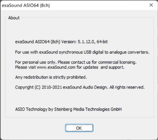

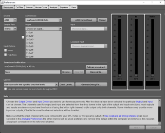

Hi. I am knee deep in system measurements for creating DSP filters. When I use Audiolense XO, both the ExaSound DAC ASIO driver and my Umik-1 are discovered and used. However, with REW, I can select the ExaSound ASIO driver (see screenshot) and all speakers in my surround system are shown. No input shown. When I click on "ASIO Control Panel" I get this error message (see screenshot). If I try to use a third party ASIO driver (for example, ASIO4ALL), the best I can do is 2 channel stereo.
Is there some setting I am forgetting to use to enable the Umik-1 with the ExaSound DAC ASIO drivers? There are some features in REW I would like to use as a complement to Audiolense XO. If this is a stupid question, I apologize. Thanks, Marcus
