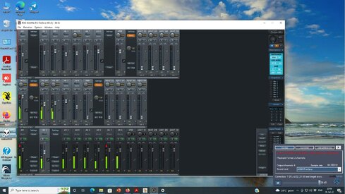

I've used AL some years ago, but never in a .1 setup, only multiway stereo. Now I'm struggling with a 2.1 setup. When I test speaker connection, the tapping sound for the subwoofer comes from the left speaker. I also have a new soudcard(RME Babyface), so the problem might be related to that. I've attached som screen dumps, can anyone see any problems with my setup?

One step closer, now I have the test signal for the sub in both sub and left speaker.

Can you show how the measurement window looks like? do you use the physical outs or digital/midi?

Here's the measurement window.

When you tap the check speakers bottom does "output channel 0" show channel 1 in the Patchmix DSP? I don't see 3 physical outs in your pathcmix. Did you use this RME with AL before? There is a way to split the two AS 1/2 to two channels AS1 AS2. I have a different RME and this is how it looks.

Not quite sure what happened, but now it's working. Pulled down the marked fader and it worked. Now the fader is up again, but it still works. Time to do some measurements!
