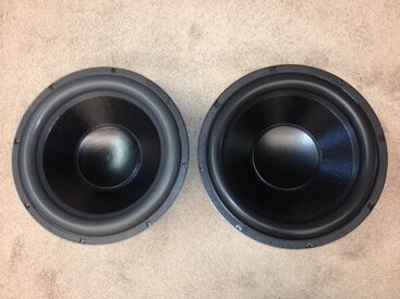

2) Here's a shot of our updated 18" driver next to the current 18" driver(updated driver on right). The main (visual) difference is the color of the surround. The updated driver has a much darker surround hue. I was asked on another forum if we're going to do an upgrade program and we are not. I will copy/paste the reasoning below.
We actually do "running changes/upgrades" on the drivers and amps on a fairly regular basis. Both the 15 inch and 18 inch have been updated a multiple times since they were introduced. The update can be for performance purposes, longevity purposes, assembly consistency, or even aesthetic consistency. Unless there's a significant(easily audible) improvement it's nothing we really make a big deal about.
The *SE* upgrade you referenced is a good example. Pretty significant (audible) benefits but it also came with a big cost increase. So we wanted to make sure we informed everyone that although we were forced to increase the price on the subwoofers, there were performance gains involved we felt were well worth the price differences. And a byproduct of that was also offering the *SE* upgrade kits.
In this case, I wouldn't describe the update as offering a significant performance difference so we're not going to offer upgrades. If it wasn't a clearly visible difference I wouldn't have even mentioned it

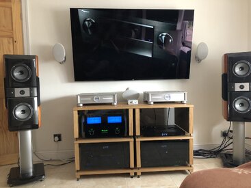

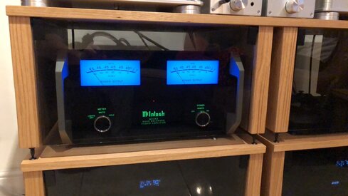

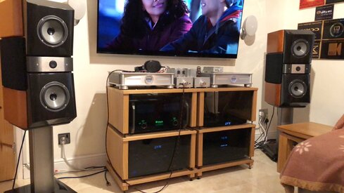

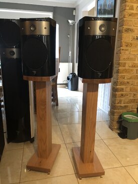

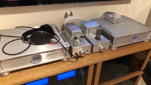

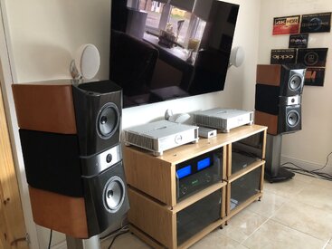

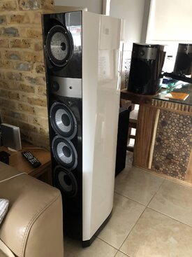

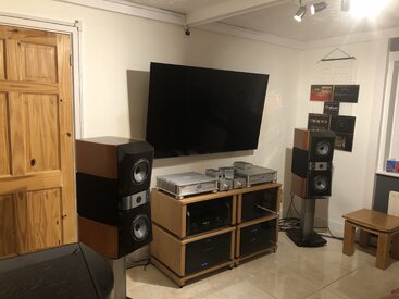

I currently have 1 of the S3600i and 1 S3601m
Hi guys sorry still getting to grips on how to post and add pictures.
My setup is
Focal Utopias Front L & R on a Mcintosh MC452
Focal Electra 1038be Left & Right on Edge G8+ monoblocks
Focal 1008be Back Surround Left & Right on Pioneer SC-LX901
4 x Kef crr200i thx in ceiling for Atmos height
On Pioneer SC-LX901
1 Power Sound Audio S3600i
1 Power Sound Audio S3611
Woo Audio WA6 SE Headphone amplifier
And I am currently ordering the first S7201 to come in to Europe and selling the S3600i

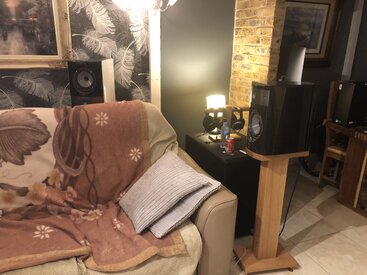

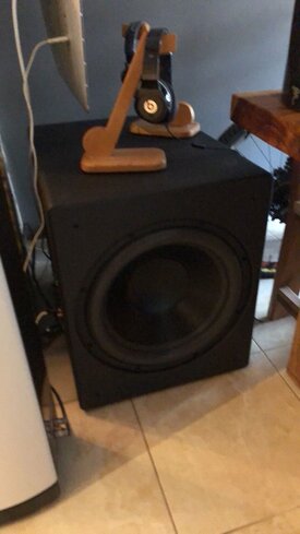

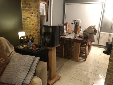

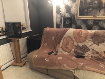

Hi everyone
Really excited the S7201 should be here within a week, so now I have to place it somewhere which is not so easy in my room, I can’t place it in the front where my main l & r speakers are as the cabinet is there see picture, I have the other 2 PSA S3601 & S3600i subs on the back wall either side of the sofa see pictures.
One S3600 is in the left corner of the MLP up against the brick wall where it then opens out to the dining room and the other S3601 is in the right corner of the MLP so not sure where I should place the S7201 and it’s replacing the S3600i and I am keeping the S3601.
Not sure if a corner placement is right for the S7201 ? What has others done ? Hope the pictures help show the room
