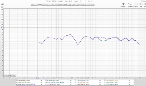

The new XO filter settings impacts the delay timing needed for good SPL support. It is possible that the new XO settings will work better than the initial settings. It is also possible that this new XO filter setting will not work as well. I can run the needed analysis of this new XO setup if the needed measurements are posted. That way we can see if this is a positive change or not.
Measurement 12 is a defective measurement. Look at its impulse response compared to the others. Something went wrong. All the LR2 measurements are meaningless for SPL until the the correct delay timing is determined and implemented. I see no compelling reason to worry about these other XO options though. Why not just use the original 'LR4+LR4 at 2.5K inverted' combination. The small sag in the SPL can be addressed with EQ. If you like though, I can determine the delay needed on one of them if the correct set of 6 measurement are provided as you did before in Post-21.
