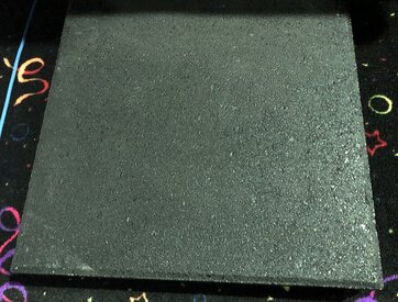

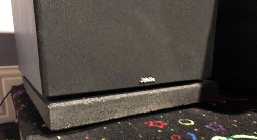

When I upgraded my subs recently the 18” x 18” isolation/de-coupling risers I had made were too small to use under my new Rythmik F18’s. They did catch the feet, but just barely, (the F18’s are approximately 20.5” x 20.5”) and did sit on the isolation pad but the overhang made them look aesthetically unpleasing to my eye.

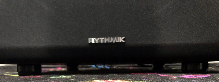

I ended up sitting the F18’s directly on my carpeted floor using the substantial rubber feet supplied by Rythmik. They work very well as feet but I was getting a lot of transmission through the floor to rest of the house.
I had intended to build my own 20.5” x 20.5” x 3” concrete pads but then stumbled across the SVS SoundPath Subwoofer Isolation System. Being basically lazy I said “Hey! That looks like the way to go! NO MESS, NO MUSS, NO FUSS!”

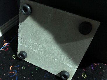

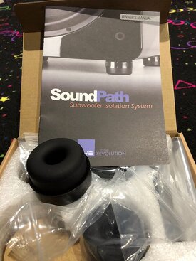

When I received the SoundPath feet I pulled them from the box along with the screws and looked them over. Fit and finish looked very good and the black/silver anodized steel shell holding the Elastomer foot gave it a nice, polished, finished look that I couldn’t match with my homemade ISO Platforms :-).
I tilted over one of the 115lb F18’s and removed the first rubber foot. “Hmmmm!” I thought… “That’s a big humpin’ screw!”. Yes Martha, it was bigger than the SVS supplied screws… the Rythmik supplied feet were 3/8” screws, considerably bigger than the largest SVS supplied ¼” screws!
I tried to insert the Rythmik feet into the bottom of the SVS SoundPath feet to see if they would fit in the hole… They didn’t.
Here is where my level of commitment started to waver a bit…. But then I sucked it up and went to Home Depot and bought eight 3/8” x 1.5” hex head bolts. Knowing these would be too long I also bought eight matching nuts to use as spacers.
Going home I wrapped the steel shells with cloth and anchored them in a nice big Monkey Wrench and drilled the holes out to 3/8”. One screw and one nut later I was installing the feet on the sub. I repeated the process on the other sub and turned on the system.

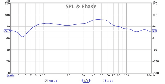

In order to dial in the subs and system I decided to take some measurements and then rerun Audyssey.
Here is my 0-200HZ curve after installing the SVS System but before correction
I liked it but thought I could do better :-)

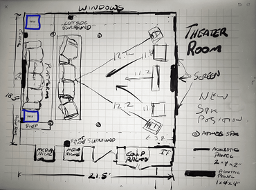

So I started experimenting with the speaker and sub placement in the room, working to fix the phase issues and notches that appeared after swapping the feet.
Here is what I came up with…. Not perfect, but… overall not bad either. I ended up pulling the LCR out from the wall to about 3’8” at the drivers and the subs out to 3’2” at the face of the sub. This pretty much aligned the subs with the drivers on my main speakers reducing the time/phase mismatch. A little fiddling with the Phase Control on the F18’s and distance settings on the Marantz Pre/Pro and things were working well together.
Here is my 0-200Hz curve before I installed the SVS SoundPath Subwoofer Isolation System
New Speaker Positions
Curve with the SVS feet installed and redialing/relocating in the speakers/subs
