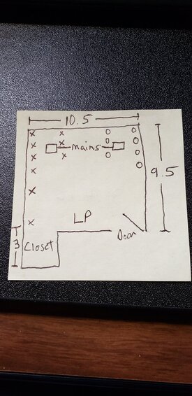

By the way, the SB-3000 is installed in the best position of seven tried, and with phase adjusted on all three subs to get smoothest response when they and the mains are playing. The SB-3000 supplements the JLs nicely at both ends of their frequency range, and the result is firmer and more even bass -- very nice! Piano left hand is fuller and more solid, really about all I could ask for. The one remaining nit is a little too much upper bass, which I'm hoping to get rid of by adjusting the crossover settings in ARC.
Here is a napkin draft of all the positions I tried, X being left SB3k, O being the right. I ended up putting them where the mains are depicted, lol.
Still playing with the app's DSP phase on both subs and I bought GIK corner traps and absorption panels, Phase 1 of a two phase plan to conquer this small room.
Well, good! I have better results since adding a third sub, placed asymmetrically. Bass got smoother and more extended. Even my trials with a small B&W 10" sub made things better. Something you might consider, even in your smallish room.

@Mike-48 , I do have a NIB SB12 NSD I could add, but will likely sell it and just get a third SB3k for the DSP app.
