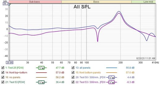

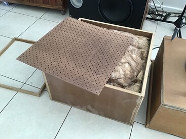

Most important is the massive low frequency issue, but you know that. Rockwool is a poor absorber but you've got it so maybe you can improve it prior to moving up. I'v attached test result I made some time ago as part of my own research, although I took the rock wool research no further. The blue line indicates 300mm rock wool with a 4mm resonator panel in front while the purple indicates replacing the panel with 5mm pegboard . You will notice a substantial improvement in absorption but at the cost of introducing a 125Hz notch. Raw rock wool gave almost no absorption to low frequencies (below the 200Hz 'transition' frequency)

Absorption will improve markedly with the pegboard. Remember to have the board on the room side. It seems counterintuitive but the board will really move with the bass. And trap some of the return energy giving you bonus Absorption. And it’s a cheap modification. If you make a frame of 1/2 inch square mdf and mount it inside the carcasses so the pegboard is a little below flush you can glue the pegboards to the frame. This helps keep the resonance modes aligned. We want phase coherence at this point at all costs.
cheers
Kanef
