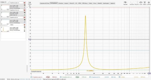

Radian
REW does a good job of measuring impedance. These are graphs of three calibration steps and midbass impedance. Rsense 34 Ohm. Open circuit resistance 100 Ohms, short circuit resistance 4 Ohms (almost).
How could your test leads have such high resistance?
During the failures with the second step it was 18 ohms. So I was glad that somehow it became 4 ohms. But since you say that this is too much, I will try to find out why. Thank you.

I found the reason. Poor contact TRS male - TRS female on the measuring wire. Maybe some grease got on the contact. Now the short circuit resistance is equal to the resistance of the test leads. 0.6 Ohm. Thanks, John.
