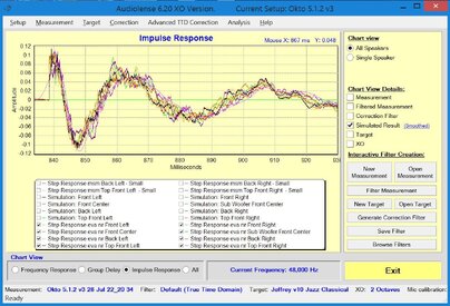

Example attached. Front mains, subs, center and top height speakers are essentially all in a straight line. Note how the subs measure so far off the other speakers. JCR

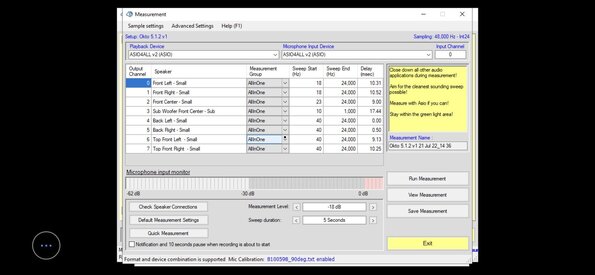

No, Omid, these are GoldenEar SuperSub XXLs that have crossover but no DSP and no polarity adjustments, either.
As noted above, outcome is not in question. See results attached. JCR

A bit hard to read but I think I see 7 step responses, where there should be 8. I think none of these step responses represent the subwoofer’s step response.
Can you zoom out and see if there’s another step response a bit later?
