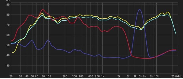

I have now made some different measurements through my portable CD player and through my surround system at home.
Yellow curve: Sweep measurement with laptop and portable CD-player via cable. REW generator.
Cyan curve: PN measurement with laptop and portable CD- player via cable. REW generator.
Blue curve: 3000Hz sinus tone with laptop and CD-player via cable. REW generator.
Red curve: PN from tone generator App via BT from iPhone to Samsung surround system.
You can see that significant drop on the red curve. I have the same drop when I make measurement via iPhone with USB-cable and Carplay in the car.
This is really strange. I always use Carplay with cable when I listen to music in the car an all the frequencies will be heard in the speakers. I don’t really understand why those frequencies above 3000Hz will be cut off when I use the phone as a signal source for the measurement in REW.
It is also strange that those sub tones not will be heard in the car when I use the tone generator in REW though the AUX input of the head unit. When I play sub tones from REW generator through my portable CD-player at home everything will work as it should.

Forget everything that I have been written before. I now feel very embarrassed since I have made a “huge” mistake.
It was just a setting in the tone generator app that had been changed. I had the sample rate set to “match source” instead of “48000hz”.
