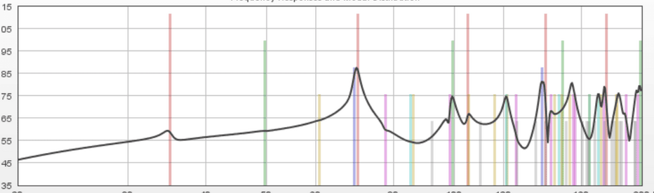

Is this a good response simulation using two subs?
34750
This is the simultaion without subs
34752
This is the room
34753
7,349
Levels and left/right balance look much better on the latest measurements. Subs can help a lot and offer more placement options, and the ability to vary the phase at the crossover point between subs and mains. They need experimentation, rooms can behave differently than their dimensions might suggest depending on the materials of the walls, floor and ceiling and the positions of doors and windows so the simulator can only give potential starting points for making measurements.
