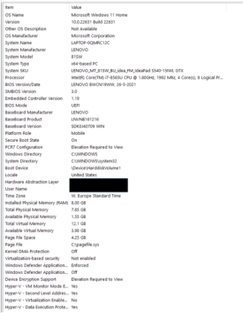

This problem is not limited to the ASIO drivers, it also happens with the JAVA drivers. I downloaded the drivers for the Behringer device from their website. I am using a Lenovo S540 laptop running Windows 11 (specs attaced).

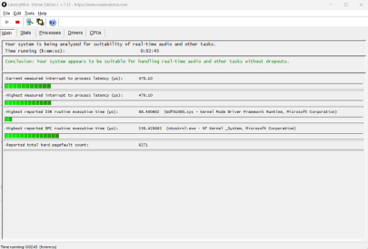

Latencymon can show what stops your PC managing to maintain continuous audio data transfer. The higher the sample rate, the more likely whatever is causing the problems will intrude. For reference, I don't have any problems running at 768 kHz with the one interface I have which supports that, there isn't an REW issue.

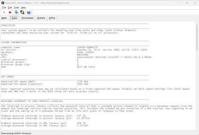

Attached the results. These were run without running REW at the same time.

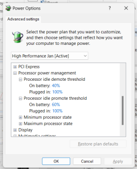

I searched on YouTube for Latencymon uses and followed a guide to remove any latency problems. Since I am not allowed to include any links, search for "How to FIX High DPC and ISR Latency in 60 Seconds". I changed from Balanced Mode to High Performance mode and applied all suggested settings in the video.
I did not use the app that is linked in the video, instead I used another site Google for "Hidden Power Settings" and you will get a Microsoft site that provides two command lines to enter in Command / Terminal mode to give access to Idle Promote and Idle Demote settings (attached).

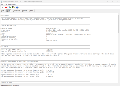

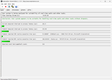

Attached are the new Latencymon screens. I Guess I can't get any faster than this.
Then I reran some sweeps and now there is no more static. All sweeps work, both in ASIO and JAVA (last sweep). All results attached.
