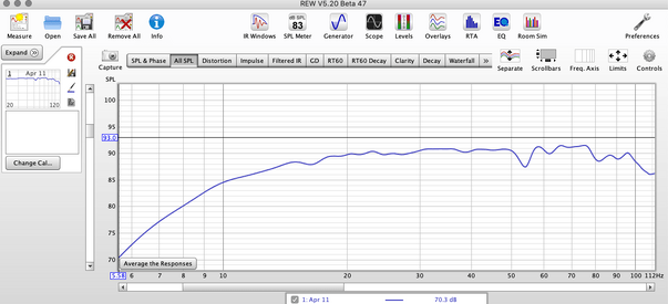

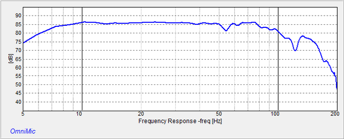

I have been using OmniMic for 10 years or longer but needed to validate its perfrormance on my LFE channel. So I used REW. From the two plots below, the results between about 20Hz and 100Hz are close enough. But south of there, huge difference. How accurate is REW south of 20Hz?. I have had the miniDSP mic for a very long time but never used it and I did download the cal file.

Hard to say with what you gave us to go on. One can’t make a valid argument for or against either platform without knowing if the measurements were taken with the same mic and calibration file.

OmniMic uses it own mic and the associated cal file just like REW uses a miniDSP mic and associated cal file. I would have expceted some minor differences but not like what I got. What I would like to know is if I could use my much more expensive ($900) mic and associated cal file into a USB mic preamp into REW. ?.

Why do you assume the issue is with REW, and not the miniDSP mic and / or its calibration file? And, why do you assume OmniMiic is the one that’s accurate?
Again, both platforms will require a measurement from the same mic and calibration file. Without that we can only guess about the discrepancy.

Both look the same at 20Hz, one drops about 5dB by 10Hz. I wouldn't sweat subsonic stuff. Be sure that REW is not set to C Weighting. Best not use Cal files when comparing.

I do sweat the subsonic stuff since (a) I paid good money for it :redgrin: and (b) I would like to know which one is correct so I can account for it. The OmniMicplot shows I’m down 5dB at 7Hz while the REW plot shows I’m down about 8 or 9 dB more. Also could be that neither of them are correct!!

Good money? I remember that..... I guess you are trying to figure out if the Omnimic app or REW is telling the truth. Omitting the Cal files removes a layer of possible confusion.
Can you look at both Cal files and see if they are different down there? I reckon these are auto factory jobs, not lab quality, manual.

I took a look at the cal file I downloaded for my miniDSP mic and noticed there were NO correction values below 20Hz. That would most certainly explain why my LFE plot took a nose dive in that region. Is that typical for one of those cal files or is there another place I might obtain one that go further down the spectrum?
