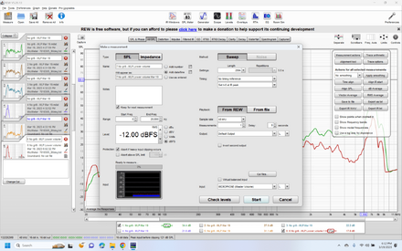

Select just one output channel rather than L+R. Can you attach screenshots of the Measure dialog and the REW soundcard preferences?

Screenshots

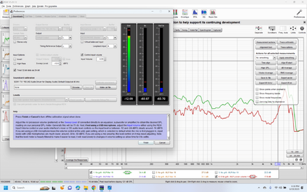

Meters active screenshot. Look at low IN levels

6,648
Those levels are certainly not normal, background levels would normally be -70 to -60 dBFS. The USB connector in the back of those older UMIKs is very stiff, are you sure it is fully home?

Cable is tight. Brand new mic and cable. But I agree the input level must be the problem. ?? What can I test or check?
6,648
The problem might be noise cancellation processing, which Windows tends to apply by default to any mic input that provides stereo data (it assumes that one channel is signal and the other is background noise). Make sure enhancements are not enabled on the Windows audio input properties Advanced tab (System - Sound - Related Settings on right hand side - Sound Control Panel - Recording - select UMIK, click Properties button) or Enhancements tab. Some PCs may have a separate application with similar noise cancellation features for mic inputs, e,g, Waves MaXXAudio, HP Audio Center, myASUS.

We are looking into that. When we "check levels" my voice makes the IN meters go up. But the white noise does not much. My voice on top of white noise does make IN meter go up though.
