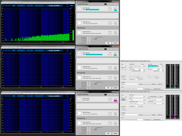

Yes, I had to bypass java if I wanted to monitor with a 24bit depth.

Why ? I use JAVA at 24 bit !
java doesn't choose the WDM version [on my Windows 7_x64 system, REW V5.19, devices.png attached earlier], and its selection of MME was limited to 16bits (changing this setting seems to be impossible). I came across a thread from ~4 years ago where someone else ran into this, the VB-Audio cable author suggested wdm or ks, which is why I went to asio.

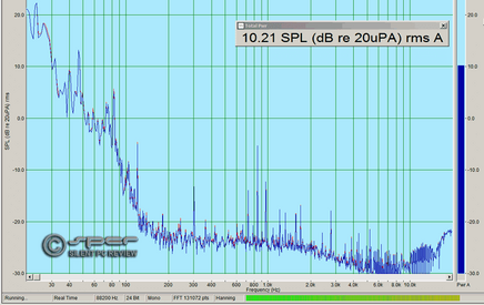

I'd like to measure things in the 6 to 40dB(A) range but I'm unsure if a small scale chamber can compare to a dedicated room, like someone else had built [attached image] in their home in terms of dampening broadband down to 200Hz.
