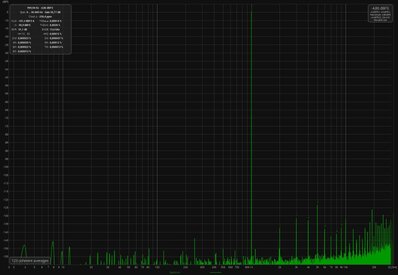

I have verified a difference in the noise level when enabling the THD measurement with the average function active.
I attach two RTA screens with a 1 Khz -4dbfs signal, the first with the THD measurement and the second without, you can see a notable difference in the noise level which is much lower when the THD measurement is active.
Is this normal behavior?
Thanks, regards.
Antonio
