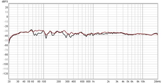

ok thanks. In fact I continue to take measurements with acoustic timing inserted. But I wanted to ask you. In your experience, is the red curve or the black curve more musical?
