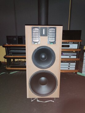

I have been playing around with a new centre channel, 3-way with twin woofers, twin mid panels and single ribbon tweeter. They are in a vertical line on the same baffle and closely aligned. I have taken measurements with REW of each of the 3 components and have been trying to use REW to time align them.
In the Impulse screen one can ask REW to estimate IR Delay and these are the results I got: BTW I have repeated these measurements multiple times on different days and the "anomaly" persists.
I have not used a timing reference.
Woofer -1,365.2757ms (-468.290m 1536 ft 5 in)
Mids 0.0431ms (15mm 0.58in)
Tweeter 0.0521 ms (18mm 0.7in)
The relative delays for the mids and tweeters are as expected. There is clearly a problem with the woofer delay. There is one 12" and one 15" running in parallel in the attached measurement but I get the same anomalous result when measuring the woofers on their own.
Interestingly, if I look at the actual graph and the maximal amplitude of the signal, the calculated woofer delay would be about 0.175ms
I would appreciate your views on what could be causing this incorrect woofer IR Delay calculation and any advice appreciated.
regards
Jose

7,330
That's a bug, triggered by the left hand IR window being very long and longer than the right. I'll fix it, but in the meantime I can't think of a reason to use a left window longer than the right, or one that is so long. If you set the left window to something much shorter the result will be correct.
