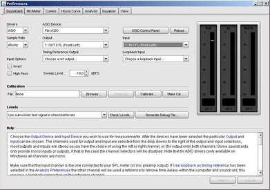

Hi, FlexASIO author here. Sorry to revive this thread, but it's one of the first results that come up on Google when searching for "flexasio", so I'm here to clarify things.
FlexASIO in itself doesn't touch the audio. Neither does PortAudio, aside from sample type conversion, which cannot cause such issues.
The issues you've experienced look more like you have something messing with your signal in your shared Windows audio pipeline, such as an APO ("enhancements" that come bundled with hardware audio drivers). FlexASIO by default uses a shared backend, just like a normal Windows application, which means it does not bypass the shared Windows audio pipeline. I would suggest adjusting your configuration to use WASAPI Exclusive Mode or WDM-KS, which will not go through the shared pipeline. With such a configuration you should achieve results that are identical to ASIO4ALL in terms of signal integrity.
I suspect this might also be caused by audio glitching issues, which could potentially confuse REW and mess up the measurements. If you believe that's what's happening, I would suggest increasing the buffer size. If that solves the problem then I would be interested to hear about it, because it probably means the default size is too small and I should increase it.
In any case, if this doesn't help, do feel free to file a report against FlexASIO and we'll investigate in more detail.

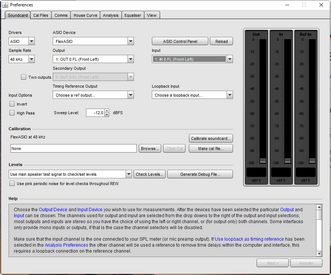

I had the same problem with REW not detecting my nVidia GT1030 card as a device. First I tried updating the driver from my 399.24 to the latest 418.81, did a full reboot but still no joy. Then I installed FlexASIO and after a full reboot, yahoo. Now showing 7 channels of speakers and a "Check Levels" puts sound from each when chosen.

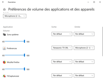

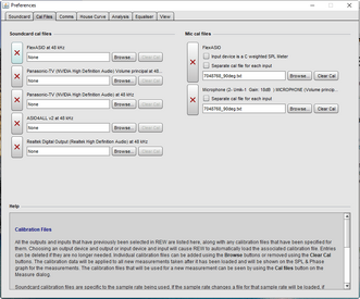

Hello, i have the issue with ASIO Driver and my NVIDIA card (GTX 460M). I installed the flexASIO driver and now i can select my output signal over hdmi BUT the level return by the Micro (USB UMIK - 1) is very low.
for instance , if i use the internal micro of my PC the spl meter measure about 35,5. If i do this same test with the USB UMIK - 1, it measured about 16 in a quiet room. IS somebody have an idea ?
Nota : i tried calibration of my speaker (at 75 db spl) with this configuration and i never reach this measure(75 db) and my speaker burnt
Help me please
To get correct readings from the UMIK you need to select it as the input and load the mic cal file. You should also check what the level setting is for the UMIK, on the Levels tab of the Windows sound properties or shown on the input volume on the REW soundcard preferences. Attach a screenshot of your REW soundcard preferences.
Thank for your answer. with ASIO driver, the UMIK Micro don't appear in the input list, it appear only with java driver. see attached files
