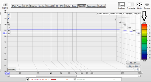

5. When I switch back to the Waterfall screen, the screen is now blank, and the scale on the right now shows -120 to -150dB!

Settings screenshots:
I checked, and the settings I use are the same on both the desktop PC and the Laptop. Another anomaly is that the Spectrogram looks different on the Desktop and the Laptop.

I also used the Windows "Steps Recorder" to record the keystrokes and screens as the issue is being reproduced. The Steps Recorder is an interesting tool--let me know if you find it useful. You can download the session recording here:
https://www.dropbox.com/s/jzwauwarmfmqlf2/REW Issue Steps Recorder.zip?dl=0
Step 1 shows the initial measurement sweep, using the test file I sent you.
Step 2 shows the normal-looking Waterfall.
Step 3 shows returning to the All SPL screen.
Step 4 shows a return to the Waterfall page and a click on "Generate" to re-generate the Waterfall.
Step 5 shows that the Waterfall is no longer displayed, and the vertical scale now shows -120 to -150.
Steps 6 thru 9 return to the All SPL screen and setting the smoothing from No Smoothing to 1/6 smoothing.
Step 10 shows that the measurement has disappeared from the screen in the background.
At no point in the steps recording are the Poltergeist captured on the screens. :)
And still no errors in the REW log.

Thanks Jerry. Already looks broken at step 2, since most of the waterfall is missing. After you first load the file is all of the impulse response present?

The waterfall is definitely broken. Laptop waterfall:
Desktop waterfall:
