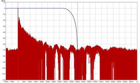

Thanks Jerry. Already looks broken at step 2, since most of the waterfall is missing. After you first load the file is all of the impulse response present?
AFAICT, the laptop impulse looks to be completely there:
