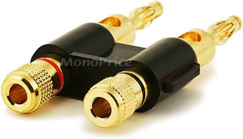

I've used these for both speaker and receiver speaker wire connections and have found them very handy. Color coded, stackable, and no-tool firm connections for both wires connected to them and the banana plugs themselves, even when stacked ($6.95 for a two pack). Admittedly, Radio Shack used to carry a slightly beefier variation, but these work well just the same. Also handy for one setup where I need to be able to easily disconnect the speaker wires mid-run (I know; the horror! - not to worry; that's a garage setup).One advantage to these is that the speaker wire connects very close to the banana jack end of the plug so the weight of the wires is supported nearly as close to the back of the receiver/speaker as possible reducing the strain on the jacks that the plugs fit into.

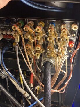

I like this review, so much great info... I've resorted to buying factory terminate speaker wire from Monoprice. I'll add a photo to this thread when I'm down in my workshop later today... but the terminated ends have a screw-on metal cap that ALWAYS falls off. I've slowly been adding blue loctite to every cap (which stops the problem from happening), but until that's done the metal caps have a nasty habit of falling off and getting lost. Will drive you a tad nutty!

Id like to see the pics of the Monoprice terminations when you get to it!
