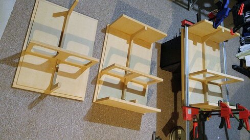

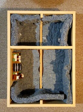

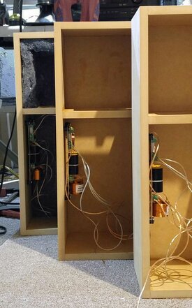

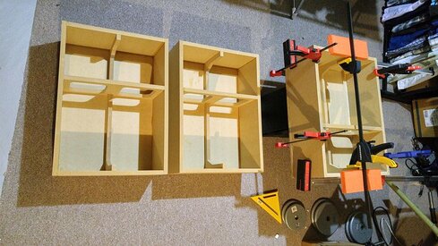

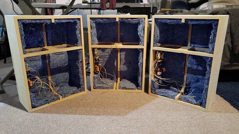

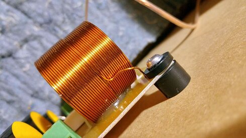

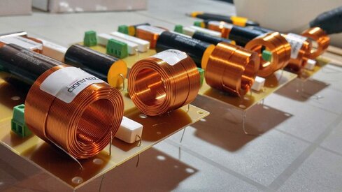

It took a little while, but I have finished all 3 speakers. I haven't given them a PROPER listening test yet, but based on a test session in my normal setup with just 1 replacing my usual centre channel, and casually listening to some tunes in stereo in the basement, they sound very good. Here's a brief summary of the build.

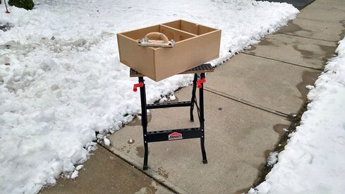

And here is the second half of the build. I wanted to finish them in something like flat black, since they will be behind the screen. I'm a big fan of "mistint" paint, and so when I stopped in at a Sherwin Williams store and found a can of "blacktop" in a flat finish for $10/gallon, I thought I'd hit the jackpot. It turns out that blacktop is a little greener than I'd ideally like, but since they will be hidden I don't mind so much. They are dark and flat, and will do the job just fine.
I don't think this is actually necessary, but I had a bunch of Dynamat on hand, and figured I'd put a strip on the back of each of the waveguides to help damp any vibration or resonance. They are very thick, and very well made, so I doubt I've gained much but I think I was maybe able to tell a TINY difference with a knock test.

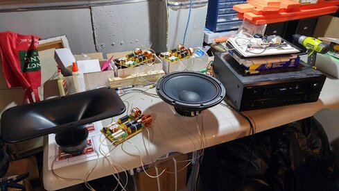

And a few pics of my very very basic initial testing. I will say that in place of my usual Paradigm CC-370 there was a dramatic increase in volume and clarity for the centre channel. That's one of the main goals behind this project, so it made me very happy.
Very nice so far. Dual 12's should be enough for dynamics I hope. :greengrin:
Yep... I think these will be enough in the tiny little room they're going into. :redgrin:
When i was listening in the basement I had them hooked up to my old Denon rated for 70wpc and they had NO trouble getting loud. Whatever AVR I end up with for the theatre will likely be 120wpc+, so they'll have the potential to send people running from the room. :hush:
