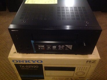

Picked up an RZ 920 9.2 channel receiver just after Christmas, I will do a full walk through of the setup and operation along with my thoughts along the way.
First of all the specifications:
Amplification for 5.2.4 channels in Dolby Atmos or 9.2 channel soround
135 Watts - 8 Ohm - at 1 kHz - THD 0.08% - 2 channels
175 Watts - 6 Ohm - at 1 kHz - THD 0.9% - 1 channels
Class D amplification
36lbs
THX select certified
Dolby Atmos
DTS X
Dolby Vision
Seven HDMI inputs plus one on the front all HDCP 2.2 compliant
Two HDMI outputs
Supports HDR10, HLG, Dolby Vision™, BT.2020,
4K/60 Hz, and HDCP 2.2

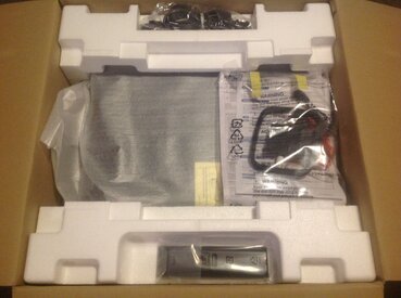

The unboxing:
Opening the box, inside is the receiver, remote, manual, AM and FM antenna's, room EQ mic, power cord and batteries
The receiver is solid, and weighs 36lbs. now thats a fair bit lighter than my previous Onkyo TXSR805 @54lbs (I was reminded of its weight as I pulled it off the shelf in my AV rack last night) but given the RZ920 has class D amps this weight is expected to be less. After labeling all my connections as I pulled them of the old Onkyo I was glad I did as I dont have a light in the closet where I access the back of the rack (note to self, install light).
The RZ920 has 7 HDMI inputs so that will future proof it for some time as I was finding that on occasion that I was having to swap HDMI cables on the old Onkyo because it only had 3. The 920 also has another HDMI input under the front flap for hooking up a video camera or other device. The 920 also has a number of analog composite inputs including a phono input (something lacking on many newer receivers these days). It also has pre outs for all 11 channels including the height used for Atmos.
The one thing missing on this receiver is a switched outlet for that matter it has no power outlet at all and I might note as well that the supplied removable power cord is much lighter AWG than my previous 805 and thus my immediate decision was to keep using the one that came with the 805 instead as the plug shape was identical.
The speaker binding posts are solid and my speaker wires went into them without fuss, I noted that the posts seem to be spaced farther apart than standard so if you use banana plugs that are joined they probably wont fit. A really good idea is Onkyo at some point has decided that putting a clear plastic sheet along the back side of the receiver all the way along the area where the binding posts are located to protect it from any possible shorts due to sloppy installation of the speaker wires due to loose strands touching the frame (Great idea Onkyo!)

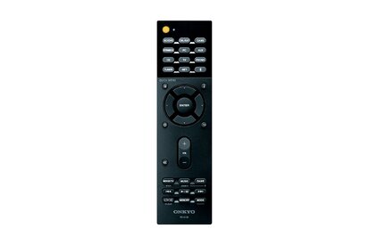

The remote control, well thats a bit of a letdown if your expecting something as grand as the one included in the old 805 era. Its much smaller and very basic. It has no glow in the dark labels or lit buttons. Onkyo has decided to go the direction of many and start using the Onkyo App on a phone if your looking for better functionality.
The receiver is equipped with bluetooth and both 2.4G and 5G wireless so its kind of hard to not use an app as it can be used anywhere within range of the receivers/home wireless network. It also has built in Chromcast and a USB port for music file playback.
Another small nitpick that I have is the sourse button labels on the receiver are very small and at my age (48) my eyesight is not what it used to be and reading them in a dimly lit room is really hard. This also goes for the other buttons under the flap.

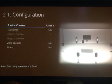

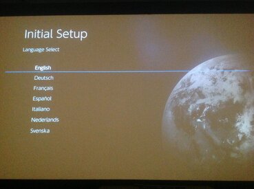

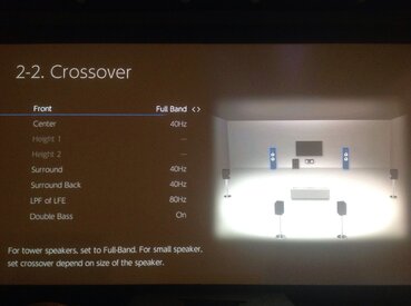

Initial setup

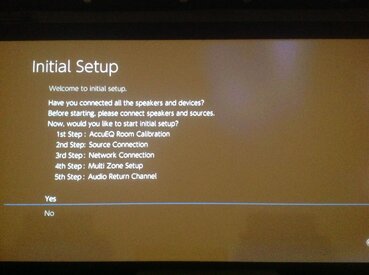

Powering up the receiver for the first time gives you the above images, moving through the steps was painless and once the wireless was connected I went straight to the Firmware update screen (not really sure why this is not the very first step in the list as you would think you would want to have the latest version installed before doing any other setup) the update took less than 20 min and the display on the Onkyo showed a status percentage all along the way.
Moving back into the AccuEQ room correction setup I was prompted to first select my speaker configuration so currently that is a 7.1 setup with no Atmos speakers yet installed. Plugging in the mic I was then prompted to be quiet (something that's almost impossible in the house with 3 daughters, a dog and of course the wife). The series of clicks, humm's and buzzing went around the room for a long time (AccuEQ takes a lot more samples from each speaker and sub than my previous Audessey Multi EQ XT did however AccuEQ only reads one position) I tried twice to do the setup but there was too much noise so I opted to wait till later this afternoon to continue when I will kick everyone out for an hour LOL.

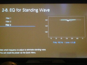

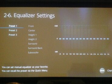

There is also a section to adjust the EQ manually for each channel and a menu for Standing wave (it has chosen 3 filters) see image.
All I can say is results are positive. At the end of my review in the next week I will post some REW graphs to show what it's doing.

In your pictures you have an adjustable eq, is that able to be used with acueq or is that with acueq off. On my 818 I can only adjust manually with audyssey off. Is each speaker able to be adjusted or just as pairs?

I just bought this and I think a couple quirks are annoying but it’s a really good receiver. I don’t like that you have to hit the info button just so you can see the audio information.
Also, I believe this is a quirk but in my 5.1.4 setup (front and back height speakers) the Onkyo display is confusing. I can hear the Atmos sound great and on the configuration screen it’s setup correctly. However, the display only shows the filling as if I only had one set of front height speakers which is confusing.
I double checked the manual and it said the rear Heights should be connected to Surround not Surroind back.

Hi Daren, have you gone through the auto speaker setup in the acuEQ and told the receiver that you are using 5.1.4. Also have you run test tones using the level calibration menus to make sure you have sound correctly going to each speaker?
Atmos will only work if your sending Atmos encoded audio to the receiver.
I have gone through auto-calibration and yes on the configuration screen set it to 5.1.4. Also, when I run the test tones it shows on that screen the correct configuration on that screen too.
As I stated when playing ATMOS sound is coming out of all the speakers when I play an ATMOS source.

If Atmos tracks play fine I am confused as to what you are having issues with? Are you saying sounds from Atmos tracks are playing out of your mains also?
The Atmos speakers should be connected to the "Height channels" not soround channels.

Have you gone into the settings and designated your front Atmos channels properly? I'm not entirely familiar with the Onkyo settings, but quite a few brands will designate front channels as wall-mounted height channels post calibration, necessitating you to dig into the settings and change them to ceiling mounted channels.
Just a thought.
