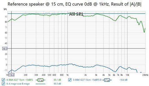

Hi John, thanks for your great support. I have initiated a monthly contribution in support of your efforts.
My question is perhaps outside the normal use of REW. I am trying to measure a microphone response. I would like to first measure the speaker response at a given position using my calibrated measurement microphone, then use that response to "correct" the response of the test microphone to compensate for the non-flat response of the speaker. So for example, if I set a reference level at 1khz, and the response of the speaker is down 5db at 100Hz, then the correction curve will boost the measured mic response by 5 dB at 100Hz. I'm wondering how best to generate this correction curve. One thought was to generate a special soundcard calibration that includes the speaker? Not sure if this is practical. Another is to use Trace Arithmetic, but I did play around with that and was not able to come up with a suitable correction curve. Wondering if you have any suggestions? Thanks.
