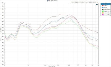

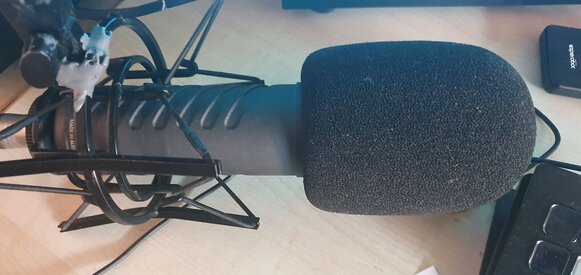

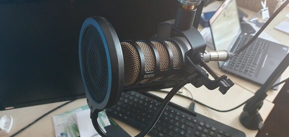

I want to get curves like the one attached.
