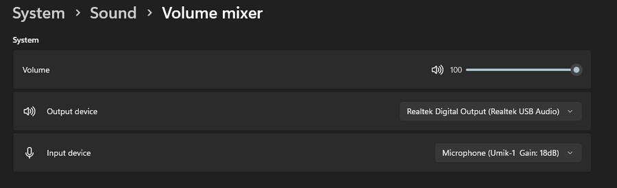

Thanks, I am going to troubleshoot this over the weekend here. I changed the default recording device to Sonic Studio Virtual Mixer in the Windows Settings. Here are my settings in Preferences and I am still getting the same error below right after hitting the red record button and having the Generator playing
Check the microphone access in the Windows Privacy settings to make sure desktop apps are allowed mic access.
Doesn't look like it. I tried to record audio w/ it in the Sound Recorder App and it sees the mic, but doesn't record anything.
OK, so looks more like a mic or driver issue. Worth trying a short USB cable to rule the cable out. ASUS laptops tend to have a microphone noise cancelling feature in the myAsus utility, should check if that or any other settings in there are having an effect.

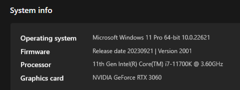

I tried two more cables and shorter ones and no luck. I downloaded the myasus app and didn't see anything there related to audio.
