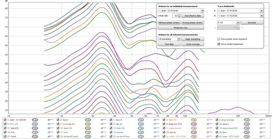

I move subs, spin them and change any setting i can. I even try to fire subs in the walls. All the time it's the same peak at 35 hz. And it's not because of a sum of two subs (sunfire play from 15-18 hz but the second one only starts at 35 hz :)) i try to measure one sub (sunfire) the same peak. I'm sure where are some positions in the room where sound be much better, but for now, i can't use them :) So need to work with what i got ;)

No. Marantz has a separated low fr. boost option. And it gives about +6 db on sub outs. i measure it in both on and off position. graphs i show before is in OFF.
About single sub performances. Here are two curves of two subs measuret one by one.
26218
red is Sunifre 12" green is Whardal 10"
And this graph of sub boost option on and off.
26219
greenline is sub boos off.
Is it possible that Audyssey is being applied to the Wharfdale and not the Sunfire? The Wharfdale plot where you measure separately sure looks like correction was applied. Are they connected to two separate sub outputs or a single output with a Y cable?
Are your LFE measurements looking basically the same no matter where you place the subs in your room?
Marc Lombardi
I think both subs EQed by audesey (but who knows). And both put in sub 1 and sub 2 outs. WD is ported 10" sub with 150W amp and Sunfire is sealed 12" sub with 1000w amp. Maybe they behave differently in room :)
No measurements is pretty different from place to place. Only spike 35 Hz is on the same place :) for example, one of the test runs
26223

hehe, panels in the room it's not a big problem :) But I will try set all to default and do measurements again, maybe its change something.

My HT room is boomy and doesn't have any treatment. so without treatment only EQ can help :) But IMO is more "last hope" weapon. I mean if you EQed sound too much, it's take off some part from it.
For real I don't remember did I reset all or just run audesey as is :) of course, I will redo it with all default before any further moves. But I'm pretty sure few tweaks will help a lot to my room.
