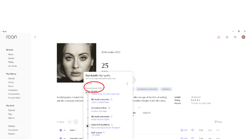

weird the zip file loads up for me in Roon (under the convolution tab)... Maybe Roon on Mac and PC behave a bit differently?
Another way to assess how much CPU headroom you have is to look it up in Roon (see pic below), if the multiplier is below 1 you might run into issues.
BTW the filter I sent you is a pretty taxing one (a worst case scenario type thing).

I think the filter is loaded and working properly 6 paths, 61k taps...55.1x
can you explain Under one.. Ive never seen that.. I was under the impression that the greater the load the higher the multiple... 55.1x is worse than 35.7x in your case? Correct understanding?
thanks Omid
The higher, the number the better. The Mac mini is clearly better than a cheap NUC unit LOL!
With 55x, you have plenty of CPU power to spare.
