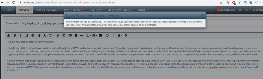

I bought the UMIK-1 mic and have practiced a bit, although I'm a REW-newbie. Now I wish to measure my 5.1 speaker output and characteristics, at their current location in my living room, through my yamaha surround sound receiver. However my laptop+desktop pc's, both only have a stereo sound card. I wish to transmit the sound digitally, i.e. through a HDMI-cable. I have read that, at least under Windows one should use the ASIO4ALL-driver (I also run LInux, but I suppose this is even worse supported). I tried (SEE SCREENSHOT, I CANNOT POST A LINK?!?!) but realize it's impossible to make it work, if the sound card is too cheap and only capable of understanding stereo, which is the case for me....
